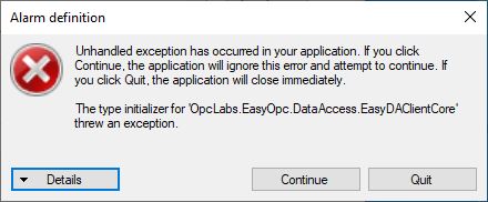

System.NotSupportedException: Specified method is not supported
It happens when running it outside Visual Studio.
a) from running it from the Visual Studio itself or by running the executable from the folder where the Visual Studio has just built it, or
b) running it from the some derived location, such as when you have built your product installer and then run the installed product.
When I run the project in DEBUG mode, I can browse OPC DA (or UA) items, but when I run the Release version, I get an exception. See below.
See the end of this message for details on invoking
just-in-time (JIT) debugging instead of this dialog box.

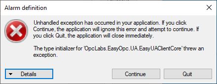

************** Exception Text **************
System.TypeInitializationException: The type initializer for 'OpcLabs.EasyOpc.UA.EasyUAClientCore' threw an exception. ---> System.IO.FileLoadException: Could not load file or assembly 'System.Memory, Version=4.0.1.2, Culture=neutral, PublicKeyToken=cc7b13ffcd2ddd51' or one of its dependencies. The located assembly's manifest definition does not match the assembly reference. (Exception from HRESULT: 0x80131040)
at Microsoft.Extensions.Primitives.StringSegment.Equals(String text, StringComparison comparisonType)
at Microsoft.Extensions.FileProviders.Physical.Internal.PathUtils.PathNavigatesAboveRoot(String path)
at Microsoft.Extensions.FileProviders.Physical.PhysicalFilesWatcher.CreateFileChangeToken(String filter)
at Microsoft.Extensions.FileProviders.PhysicalFileProvider.Watch(String filter)
at Microsoft.Extensions.Configuration.FileConfigurationProvider.<.ctor>b__1_0()
at Microsoft.Extensions.Primitives.ChangeToken.ChangeTokenRegistration`1..ctor(Func`1 changeTokenProducer, Action`1 changeTokenConsumer, TState state)
at Microsoft.Extensions.Primitives.ChangeToken.OnChange(Func`1 changeTokenProducer, Action changeTokenConsumer)
at Microsoft.Extensions.Configuration.FileConfigurationProvider..ctor(FileConfigurationSource source)
at Microsoft.Extensions.Configuration.Json.JsonConfigurationSource.Build(IConfigurationBuilder builder)
at Microsoft.Extensions.Configuration.ConfigurationBuilder.Build()
at Microsoft.Extensions.Hosting.HostBuilder.InitializeAppConfiguration()
at Microsoft.Extensions.Hosting.HostBuilder.Build()
at OpcLabs.BaseLib.Extensions.Hosting.StaticHost.CreateHost()
at System.Lazy`1.CreateValue()
--- End of stack trace from previous location where exception was thrown ---
at System.Runtime.ExceptionServices.ExceptionDispatchInfo.Throw()
at System.Lazy`1.get_Value()
at OpcLabs.BaseLib.Extensions.Hosting.StaticHost.GetConfiguration()
at OpcLabs.EasyOpc.UA.EasyUAClientCore..cctor()
at OpcLabs.EasyOpc.UA.EasyUAClientCore..ctor()
at OpcLabs.EasyOpc.UA.EasyUAClient..ctor()
at UCMECFG.OPC_UA.GlobalTagBrowseUA(String MyServerName)
at UCMECFG.Module1.GlobalTagBrowse(String MyServer)
at UCMECFG.Design1alert.Command4_Click(Object sender, EventArgs e)
at System.Windows.Forms.Control.OnClick(EventArgs e)
at System.Windows.Forms.Button.OnClick(EventArgs e)
at System.Windows.Forms.Button.OnMouseUp(MouseEventArgs mevent)
at System.Windows.Forms.Control.WmMouseUp(Message& m, MouseButtons button, Int32 clicks)
at System.Windows.Forms.Control.WndProc(Message& m)
at System.Windows.Forms.ButtonBase.WndProc(Message& m)
at System.Windows.Forms.Button.WndProc(Message& m)
at System.Windows.Forms.Control.ControlNativeWindow.OnMessage(Message& m)
at System.Windows.Forms.Control.ControlNativeWindow.WndProc(Message& m)
at System.Windows.Forms.NativeWindow.Callback(IntPtr hWnd, Int32 msg, IntPtr wparam, IntPtr lparam)

Thank you. This sis now resolved.
Can you please send me the license for this version?
Michael Meirovitz
Control See
parameters have been added to the UIAdministerApplication method since the version you used before. There are are now two Boolean parameters at the end:
opclabs.doc-that.com/files/onlinedocs/OPCLabs-OpcStudio/Late...2~UIAdministerApplication.html
The suggestion is to use True for both of them.
After installing the new Nuget version and compiling the project, I get the following error:
Error BC30455 Argument not specified for parameter 'allowChangePrivateKeyPassword' of 'Public Shared Overloads Sub UIAdministerApplication(application As IEasyUAClientServerApplication, owner As IWin32Window, clientSelector As EasyUAClientSelector, allowPullCertificateManagement As Boolean, allowChangePrivateKeyPassword As Boolean)'. UCMECFG
Any idea why?
We shall try this new Nuget version.
Our current version is using Nuget Package 5.80.192. The customer has removed this version and installed an older version that was built with Quick OPC version 2022.1.
Using this older version he could browse DeltaV items with no problems.
can you please rebuild your product with updated QuickOPC (5.82.395, now on nuget.org and our Downloads page), and ask the customer to repeat the test and send over the full error message as before?
The update is not meant to fix the problem, but it adds diagnostic information into the error message.
