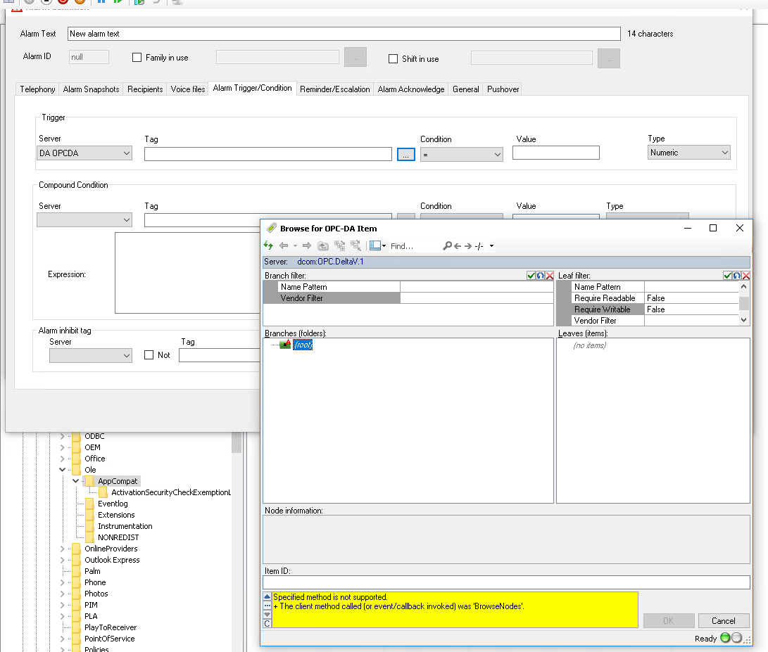

System.NotSupportedException: Specified method is not supported
23 Oct 2025 04:55 #14417 by micham
The customer just informed us that he is able to browse DeltaV OPC items. Thank you for your great support!

08 Oct 2025 04:38 #14401 by support
Thank you, this has helped. We now have more information to analyse the issue. As I wrote, the update was not meant to resolve the issue. I will let you know here what the outcome is.

06 Oct 2025 19:44 #14397 by micham
I have sent the new version that was built with the latest version of the Nuget version(5.82.395.1). The customer installed the new version but the problem persists. See the error below.
I appreciate your support..
Exceptions
Type: System.NotSupportedException
Data: ErrorId_{045406CD-8EEA-4F21-B3D6-DC9DB5A34E58}: OpcLabs.{6468EA80}
    System.NotSupportedException: The appropriate interface was not recognized for the allowed OPCDataAccess.
    The COM server supports the following interfaces:
    OpcRcw.Da.IOPCBrowse (DA30): False
    OpcRcw.Da.IOPCItemIO (DA30): ??
    OpcRcw.Da.IOPCItemProperties (DA20): True
    OpcRcw.Da.IOPCServer (DAxx): True
    ServerCategories.OpcDataAccess30: False
    ServerCategories.OpcDataAccess20: False
    ServerCategories.OpcDataAccess10: False
    This problem could be caused by:
    - incorrectly installed proxy/stubs.
    - problems with the DCOM security settings.
    - a personal firewall (sometimes activated by default).
    + The client method called (or event/callback invoked) was 'BrowseNodes'.
       at OpcLabs.EasyOpc.Implementation.NetApi.NetApiOpcServer`2.ConnectToServer(WebProxy proxy, Server server, NetworkCredential credentials, String connectionGroupName, EasyClientConnectDataParameters easyClientConnectDataParameters, ServerCategories serverCategories)
       at OpcLabs.EasyOpc.Implementation.NetApi.NetApiOpcServer`2.Connect(Boolean doOnlyIfGoodStatus, Boolean callGetStatus, Exception& exception)
        OpcLabs.EasyOpc.Implementation.NetApi.NetApiErrorHarmonization.Processed: True
        OpcLabs.EasyOpc.Implementation.ClientErrorEnhancement.Processed: True
        OpcLabs.EasyOpc.Implementation.DAClientErrorEnhancement.Processed: True
    HResult: -2146233067 (0x80131515)
    Message:
    Source: OpcLabs.EasyOpcClassic
    TargetSite: Void ConnectToServer(System.Net.WebProxy, Opc.Server, System.Net.NetworkCredential, System.String, OpcLabs.EasyOpc.Implementation.NetApi.EasyClientConnectDataParameters, OpcLabs.EasyOpc.ServerCategories)
        DeclaringType: OpcLabs.EasyOpc.Implementation.NetApi.NetApiOpcServer`2[TNetApiOpcServer,TServer]
        Module: OpcLabs.EasyOpcClassic.dll
            Assembly: OpcLabs.EasyOpcClassic, Version=5.82.395.1, Culture=neutral, PublicKeyToken=6faddca41dacb409
            CustomAttributes:
            FullyQualifiedName: C:\Program Files (x86)\Control-See\UCME-OPC\BIN\OpcLabs.EasyOpcClassic.dll
            MDStreamVersion: 131072
            MetadataToken: 1
            ModuleVersionId: 9ceb428c-1a0c-481d-9508-b4e0990afd97
            ScopeName: OpcLabs.EasyOpcClassic.dll
Message: Problem browsing OPC Data Access (OPC-DA) branches.
Source:
TargetSite:
