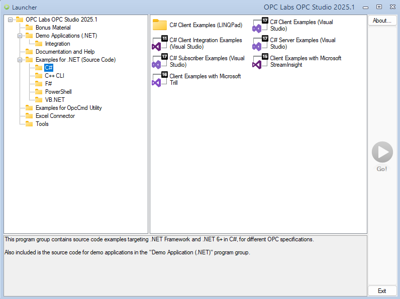

From the screen I have shown in the screenshot, open the solution "C# Client Examples (Visual Studio)".
The projects that use Live Binding for Windows Forms are in that solution are:
- WindowsForms -> LiveBindingDemo
- WindowsForms -> LiveBindingDemo2
- WindowsForms -> UALiveBindingDemo
- WindowsForms -> UALiveBindingDemo2

07 Oct 2025 08:01 #14399 by support
Attached is a picture of the Launcher program, installed with QuickOPC, which shows where to find the example solutions.
You can also find them on the disk directly - "C:\Program Files (x86)\OPC Labs OPC Studio 2025.1\Examples-NET".
Live Binding for WPF was supported in the past, but is no longer supported in the current version (2025.1). If the documentation for 2025.1 does not make it clear, I would be grateful if you send me the link to the incorrect page, so that we can fix it.

    06 Oct 2025 19:51 #14398 by Cwardltu
    Throughout the documentation there are hints of sample projects however i am not able to find visual studio projects with actual code. I found examples projects but with out code im afraid its just numbers on a panel to me. are there actual code examples?
