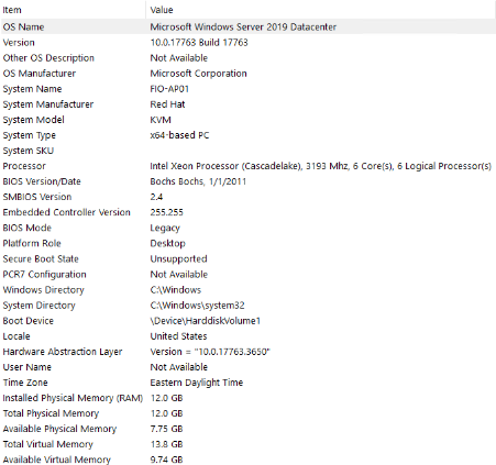

I was able to reproduce this issue on a fresh installation of Windows Server 2019 (no additional roles/features). So, there is no further need for the actual VM image, I can now work on it here.
The issue appears to be that the Brainpool ECC curves are only supported in .NET Framework 4.8+. The default .NET Framework in Windows Server 2019 is 4.7.2.
Installing and using .NET Framework 4.8 resolves the issue (4.8.1 cannot be installed on Windows Server 2019).

The VM is running Microsoft Windows Server 2019 Datacenter - Version 10.0.17763 Build 17763
Here is an image with more info:

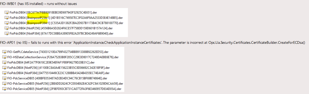

    And yes, if you do not need ECC support (you probably don't), it is possible to disable it (the problem seems to be with the Brainpool curves). See  opclabs.doc-that.com/files/onlinedocs/OPCLabs-OpcStudio/Late...%20Instance%20Certificate.html , under "Instance Certificates Auto-Generation": Set
    EasyUAClient.SharedParameters.EngineParameters.AllowEccSecurityPolicies = false;
    Let me know if that resolves the error.

    FIO-WB01 (has IIS installed) – runs without issues (This is the screenshot that contains highlights)=14pxFIO-AP01 (no IIS) – fails to runs with this error 'ApplicationInstance.CheckApplicationInstanceCertificates'. The parameter is incorrect at Opc.Ua.Security.Certificates.CertificateBuilder.CreateForECDsa()

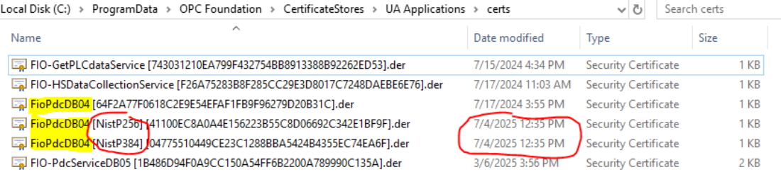

    1. From version 2025.1 onwards, it is normal to see multiple certificates, including when you have one with NistP256 and one with NistP384.

    We noticed that the new certificate has [NistP in the name and that there are two with the exact time. Could this be part of the issues we are seeing?
    ex:
    FioPdcDB04 [NistP256][12314512412412412].der 12:35pm
    FioPdcDB04 [NistP384][321511241241412].der 12:35pm
