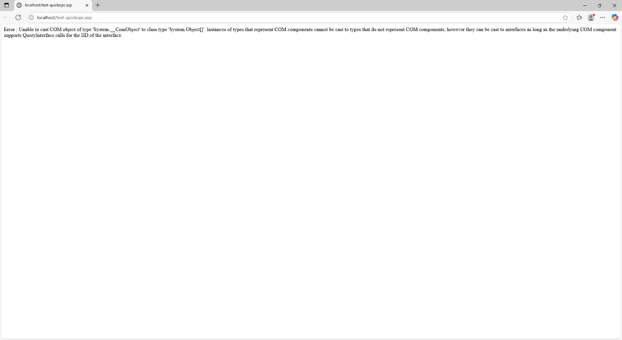

18 Jul 2025 20:00 #14331 by Kyle.Oshima@caltrol.com
re: Please post your code here..., see JScript code below (see attached .zip file containing .js file as well as rudimentary .asp file to run JScript in web browser) -- btw, am running latest OPC Studio 2025.1 version available for download

    18 Jul 2025 12:13 #14330 by support
    18 Jul 2025 02:00 #14329 by Kyle.Oshima@caltrol.com
    Looking for JScript version of  Examples - OPC Unified Architecture - Write and specify data type  available in online documentation -- tried to convert language syntax from available VBScript version, but JScript returns following error:
    Unable to cast COM object of type 'System.__ComObject' to class type 'System.Object[]'. Instances of types that represent COM components cannot be cast to types that do not represent COM components; however they can be cast to interfaces as long as the underlying COM component supports QueryInterface calls for the IID of the interface.
    Please advise.
