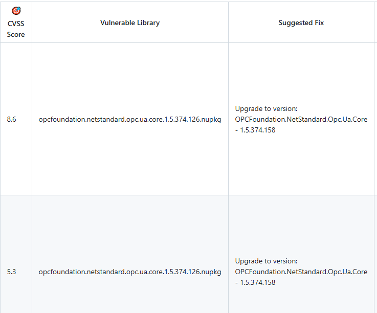

14 Apr 2025 18:26 #13548 by support
QuickOPC 5.82 will use newer OPC Foundation libraries, fixing this. Currently it looks that it might be released in a few weeks.
Important: The vulnerability ( github.com/advisories/GHSA-h958-fxgg-g7w3 ) affects *servers*. If you are using QuickOPC, which is a client toolkit, there is no vulnerability to speak about.
14 Apr 2025 17:59 #13547 by HelenPacheco
Hello I am using opclabs.quickopc.5.81.485.nupkg, but this version has vulnerabilities with opcfoundation.netstandard.opc.ua.core.1.5.374.126.nupkg, I am using Net standard as framework, to fix this is suggesting me to upgrade with OPCFoundation.NetStandard.Opc.Ua.Core - 1.5.374.158. Could you please assist or informe when this version is upgraded. Thank you in advance
