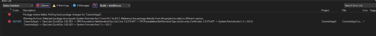

08 Nov 2025 08:05 - 08 Nov 2025 10:33 #14460 by support
Replied by support on topic .net 9 support
Yes, you are wrong.
The link I shared shows that version 8.0.1 of System.Formats.Asn1 supports net9.0. Correlate the light blue background of "net9.0" with the legend near the bottom of the page, where the same color denotes "Compatible with target framework(s)". The target framework does *not* have to be on the dark blue background for it to work. Frameworks that are not supported do not appear on the page at all.
You are also wrong about the build error. It is a warning only. It actually says it right there, at the beginning of the message you posted.
It only stops your build because in your settings, you have "warnings as errors" turned on. Turn it off.

07 Nov 2025 20:45 #14459 by Cwardltu
Replied by Cwardltu on topic .net 9 support
correct me if I am wrong but the link you shared shows that the library supports only .net8.
I was not able to create a console app and add opclabs because of this issue but i attached the error for the requested exercise.

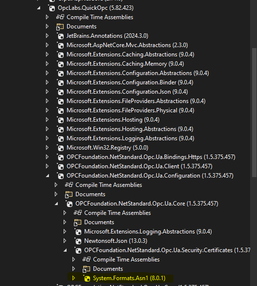

07 Nov 2025 19:12 - 08 Nov 2025 10:18 #14457 by Cwardltu
OPCFoundation.NetStandard has a reference to System.Formants.Ans1(8.0.1) . if you build this in .net 9 it will cause a build error.

21 Oct 2025 06:34 #14412 by support
.NET 9 is already supported in the current versions (2025.1).
If there is somewhere information to the contrary, I would be glad if you let me know. Or, if there is a problem under .NET 9 specifically.
