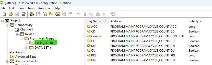

Ad 2. QuickOPC *does* support complex data types. If you are getting null reading CYCLE_COUNT, but no error, then most likely Kepware does not expose CYCLE_COUNT as a structure. There are multiple ways to confirm this. For start, do you have UaExpert? If you can read CYCLE_COUNT using UaExpert as a single structure value, then we need to look into why QuickOPC does not do it. But, as I wrote, most likely KepServerEX does not expose the value in this way - and then there would be no way around it.

2. should i be able to read a complex data type from Kepware using a single tag?  For example, i have a PLC counter called CYCLE_COUNT.  Inside of its strucure there are a handful of tags (acc, pre, dn, etc.).  It would be nice to be able to read the single CYCLE_COUNT tag and then separate the data in the PC application.  i have included a screenshot from Kepware to add clarity to my description.
i have tried this numerous ways and it does not raise a fault, however the "Value" returned is alway null.
