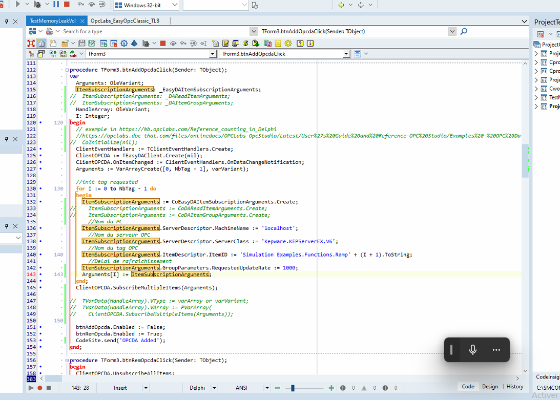

15 Sep 2025 09:24 #14366 by wsalvin
again the "I" disappear. see previous screen shot.
15 Sep 2025 09:22 #14365 by wsalvin
Oups sorry.
I just checked my code.see screen shot.
in my code it's Arguments := ItemSubscriptionArguments;
I do not know why when i copy past the code  the '' disappear.
regards
    15 Sep 2025 09:05 - 15 Sep 2025 09:05 #14364 by support
    In your code, you create the Arguments as an array, that's true. But then, inside the loop, you overwrite with just one element:
    I do not see how this can work.
    Last edit: 15 Sep 2025 09:05 by support.
    15 Sep 2025 08:56 #14363 by wsalvin
    My code is based on your exemple. the only diff is only that the number of requested Tag is a parameter and is include in a VCL app.
    I create an Array : Arguments := VarArrayCreate([0, NbTag - 1], varVariant); to pass to SubscribeMultipleItems.
    My code was working well on \OPC Labs QuickOPC 2020.2 except a memory leak.
    So I upgrade on 2025 in order to see if the memory leak is fixed. but i no more able to run my appli an i face the issue i sent you as screen shot on previous mail.
    To upgrade i installed the new 2025 release a regenerate TLB from SDK/Lib folder.
    When I run the application I checked the DLL loaded by my app and now its the 2025 one.
    Any idea of what else i can do?

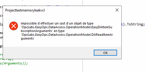

    hello i'm doing the following test In Delphi 12 with the last release QuickOPC (2025.1) I just downloaded.
    procedure TForm3.btnAddOpcdaClick(Sender: TObject);
    var
      Arguments: OleVariant;
      ItemSubscriptionArguments: _EasyDAItemSubscriptionArguments;
    //  ItemSubscriptionArguments: _DAReadItemArguments;
    //  ItemSubscriptionArguments: _DAItemGroupArguments;
      HandleArray: OleVariant;
      I: Integer;
    begin
      // exemple in kb.opclabs.com/Reference_counting_in_Delphi
      //https://opclabs.doc-that.com/files/onlinedocs/OPCLabs-OpcStudio/Latest/User%27s%20Guide%20and%20Reference-OPC%20Studio/Examples%20-%20OPC%20Data%20Access%20-%20Subscribe%20to%20multiple%20items.html
    //  CoInitialize(nil);
      ClientEventHandlers := TClientEventHandlers.Create;
      ClientOPCDA := TEasyDAClient.Create(nil);
      ClientOPCDA.OnItemChanged := ClientEventHandlers.OnDataChangeNotification;
      //init tag requested
      for I := 0 to NbTag - 1 do
      begin
        ItemSubscriptionArguments := CoEasyDAItemSubscriptionArguments.Create;
    //    ItemSubscriptionArguments := CoDAReadItemArguments.Create;
    //    ItemSubscriptionArguments := CoDAItemGroupArguments.Create;
          //Nom du PC
        ItemSubscriptionArguments.ServerDescriptor.MachineName := 'localhost';
          //Nom du serveur OPC
        ItemSubscriptionArguments.ServerDescriptor.ServerClass := 'Kepware.KEPServerEX.V6';
          //Nom du tag OPC
        ItemSubscriptionArguments.ItemDescriptor.ItemID := 'Simulation Examples.Functions.Ramp' + (I + 1).ToString;
          //Delai de rafraichissement
        ItemSubscriptionArguments.GroupParameters.RequestedUpdateRate := 1000;
      end;
      ClientOPCDA.SubscribeMultipleItems(Arguments);
      btnAddOpcda.Enabled := False;
      btnRemOpcda.Enabled := True;
      CodeSite.send('OPCDA Added');
    end;
    I face the following Error.
    Impossible d'effectuer un cast d'un objet de type 'OpcLabs.EasyOPC.DataAccess.OperationModel.EasyDAItemSubscriptionArguments en type OpcLabs.EasyOPC.DataAccess.OperationModel.DaReadItemArguments.
    Is _EasyDAItemSubscriptionArguments the right type to use for the array to pass to SubscribeMultipleItems?
