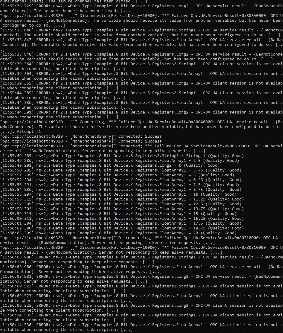

But I can see in your screenshot that around 11:55:49.286, you start getting data updates again, and therefore the client has successfully reconnected.
But - maybe - you are complaining about the fact that the lines before, which come from the connection monitoring service, end with "Connected" state with a failure indication. Is that what you mean by saying that the reconnect has failed?

24 Nov 2025 16:59 #14485 by Cwardltu
Here is the behavior I am observing. the expectation is that it would reconnect and hold on to that connection.
