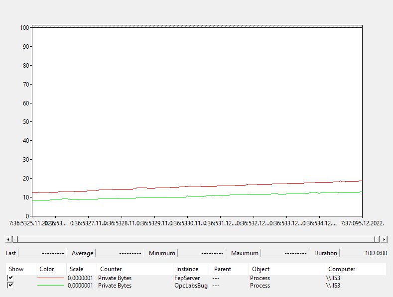

05 Dec 2022 09:56 - 05 Dec 2022 09:56 #11288 by support
In order to include attachments, they need to be selected with "Add", but then also "Insert"-ed into the post, otherwise they won't be used.
Yes, this is the kind of chart that shows the suspected memory leak behavior. I find it interesting that you have also monitored what seems to be the server application, and that it shows the same growth. This may indicate that a problem in the server causes the client to increase the memory consumption, or also vice versa - that the problem in the client causes the server to increase its memory consumption.
So, let's get back how we can reproduce the problem on our side. I know you have previously provided some Docker container. For my troubleshooting, I need a setup where I have the source code (project) of the application that uses QuickOPC, and can debug it and tweak it etc., directly on the developers machine. The server can be on the same machine, on remote machine, or running in a container.
Can you deliver the parts needed for this kind of setup (or are they already in what you have provided before? )

05 Dec 2022 07:04 #11280 by janko.mihelic@adnet.hr
Here is a 10 days of data, green line is simple test console application which is only subscribed to events, and the red line is our main application, we are sending report with image. We are connected to Prosys OPC UA simulation server receiving one event approximately every 20 seconds and are using OpcLabs.QuickOpc verison 5.63.246 on console app and version 5.63.221 on our main app
    23 Nov 2022 13:49 - 23 Nov 2022 13:55 #11233 by support
    I do not understand why are you sampling the memory consumption so quickly, and then sending over charts that only have horizontal lines in them. That is close to useless.
    You need to set the PerfMon sampling period so that the whole period (say 36-48 hours) fits on the chart.
    Regards.
